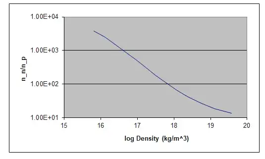

Given that $p_F = h(3n/8\pi)^{1/3}$, then the above equation can be solved to give $n_n/n_p$ and then the total mass density obtained by summing the energy densities of the neutrons, protons and electrons. The plot below shows this calculation; for typical neutron star densities of a few $10^{17}$ kg/m$^3$ it is about 100-1000.
Neutron to proton ratio
Neutron to proton ratio as a function of mass density for an ideal npe gas.
