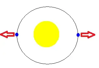

Earth rotates around the Sun (OK, around the common centre of gravity of Sun and Earth, which lays in the Sun but not in the centre of the Sun, happy now?) in one sidereal year. When positioned at the Earth’ poles, that does not drastically change your direction of view. But when positioned at the equator, you would look in quite the opposite direction (very simple model, not drawn to scale): View from earth with 1/2 year difference: opposite directions
And in the opposite direction there are different “stars”, i.e. during the year the “stars” seem to move, see Figure 5: Constellations on the Ecliptic of https://courses.lumenlearning.com/astronomy/chapter/the-sky-above/. Photographs of the night sky at different times of the year show different stars. (Please do not stand at the poles just do disprove this, otherwise I will point out the parallax.)
