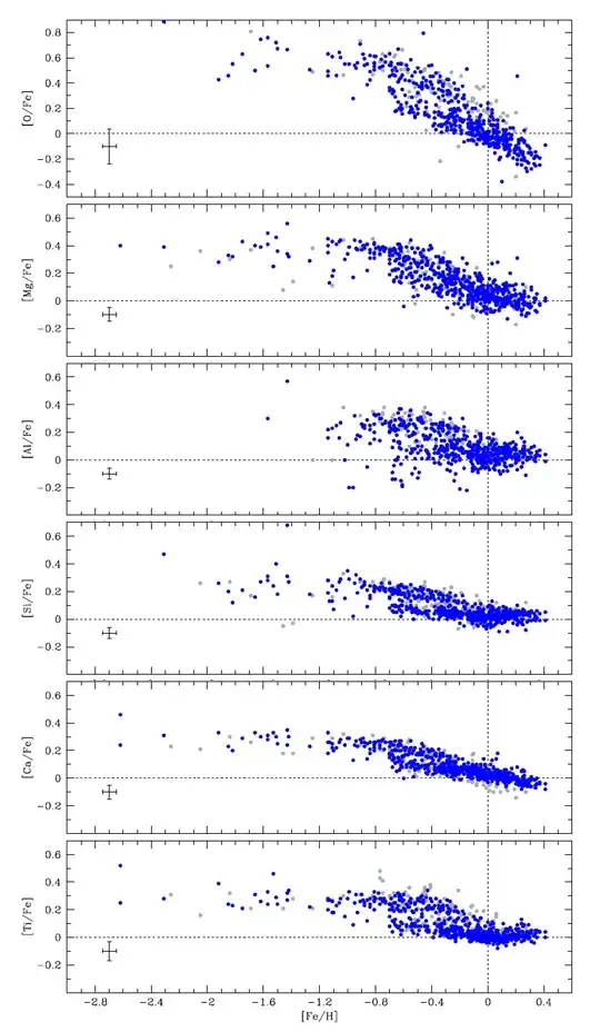

Having said that, my understanding is that most authors treat oxygen as an alpha element and the contribution from AGB stars is not sufficient to stop [O/Fe] behaving very much like [Mg/Fe], [Si/Fe] and [Ca/Fe] in stellar populations (albeit with more noise, because it is difficult to measure). The plot below is from a well-cited paper by Bensby et al. (2014), and clearly shows that [O/Fe] behaves like the other alpha elements, although there is perhaps signs of a continuing decline for [Fe/H]>0 that is weaker in the other alpha elements.
Alpha/Fe vs [Fe/H] from Bensby et al. (2014)
