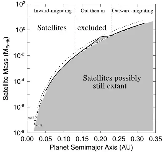

There are several factors determining the inner limit to moons. Perhaps the simplest is that it needs to stay inside the Hill sphere, the region around the planet where the planet's gravity dominates over the sun's. If the planet's orbit has semi-major axis $a$ and eccentricity $e$ the farthest the moon can orbit is $$r_H \approx a(1-e)\sqrt[3]{\frac{m}{3M}}$$ where $m$ is the planet mass and $M$ the sun mass.
The closest a satellite can orbit a planet is the Roche limit, $$r_R = r_m\sqrt[3]{\frac{2m}{m_m}}$$ where $r_m$ and $m_m$ is the radius and mass of the moon. Equating $r_H=r_R$ and assuming $e=0$ to get the minimal $a$ where a moon is possible gives $$ a_{min}= r_m\sqrt[3]{\frac{6M}{m_m}}.$$
For a Moon with $r_m=1737.4$ km and $M/m_m=27090711$ (e.g. our moon), this is 0.006 AU (948,179 km), 1.36 solar radii! This is still just barely outside the Roche limit for an Earth-sized planet relative to the sun.
(See (Donnison 2010) for a more careful estimation for the full three-body problem applied to moons. (Domingos, Winter & Yokoyama 2006) found the rough limits $a_{crit}\approx 0.4895(1-1.0305e_{planet}-0.2738e_{sat})r_H$ for prograde satellites and about twice this limit for retograde satellites.)
However, while this shows that in principle you can have moons extremely close to stars, in practice they are not going to occur.
The most obvious problem is that very close planets will become tidally locked to the sun, and that will make the moon spiral inward since it will dissipate orbital energy through tidal deformation of the planet. The effect becomes bigger for heavier satellites. (Barnes & O'Brien 2002) calculate the following allowed region in a 4.6 Gy old system around a 1 Jupiter mass planet: Fig 2 from (Barnes & O'Brien 2002) The curve scales as $m_m \propto a^{13/2} m^{8/3}r^{-5}$; for an Earth-like primary the corresponding masses have to be 2.7% of the Jupiter case (although the different tidal properties of the planets makes this estimate somewhat dodgy).
There are other destabilizing factors for small bodies close to the sun such as the Yarkovsky effect. So while a tiny moon can reside close to the sun, it will likely not remain there long.

    Note that the Barnes & O'Brien 2002 paper assumes that even large moons are still much smaller than the planet, such that the tidal torque exerted on the planet by the moon is negligible compared to solar tides. I'm not sure if (or to what extent) their conclusions can be applied to systems where lunar and solar tides are comparable in magnitude, like the Earth–Moon system. In particular, off the top of my head I cannot say for sure that there couldn't be some critical moon size above which the system would become more stable again. – Ilmari Karonen Jun 02 '21 at 13:37

The longest possible length of a satellite’s day compatible with Hill stability has been shown to be about P∗p/9, P∗p being the planet’s orbital period about the star (Kipping 2009a)
https://arxiv.org/ftp/arxiv/papers/1209/1209.5323.pdf[8]
And the source is given as:
https://academic.oup.com/mnras/article/392/1/181/1071655[9]
So this claims that a mooon can not have a stable orbit around its planets unless the orbital of the moon is less than one nineth (0.111111) theorbital period of the planet around the star.
