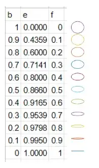

  3. Here is a table and plot that illustrates the difference in values by fixing the semi-major axis $a=1$ and varying the semi-minor axis $b$ between 0 and 1. Eccentricity and ellipticity are only equal when the orbit is either a circle or a line segment (when the orbit has no tangential component of velocity, in free fall towards the more massive body).

    Looking at that table gives another reason why eccentricity is preferred: astronomy deals with a whole lot of almost-circular orbits. Eccentricity provides far finer distinction of those orbits than ellipticity does. – Mark Apr 29 '21 at 01:59
