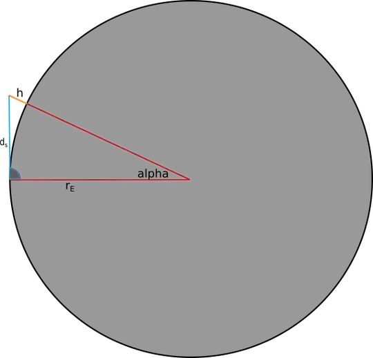

Madrid and Oslo are about 2000km apart, the Earth's circumference is about 40000km. The earth's radius is $r_E = 6371$km which allows us to calculate the angle $\alpha$ between those as seen from Earth's centre: $\alpha = 0.31$ (radians). With that angle we can calculate the height an object must be at when we look horizontally and just see it at the horizon (laying on the floor makes it easy to calculate), given it's separated by the angle $\alpha$:
image with angle and distances. h:height, rE: earth radius, alpha: angle
$$ d_s = r_E\cdot tan\alpha $$ and $$ \frac{h+r_e}{\sin 90°} = \frac{d_s}{\sin\alpha} = \frac{r_e\tan\alpha}{\sin\alpha} = \frac{r_E}{\cos\alpha} = r_E \sec\alpha $$ so that $$ h = \frac{r_E}{\cos\alpha}-r_E $$ Now if you enter the angle between Oslo and Madrid you get a height of about 79km for an object passing half-way (thus at half the angle to each). So it might have been that very same meteor if it was very close to the local horizon. Given that this estimation is pessimistic as it ignores observer height, things get a bit better if you assume that you stand on your feet, on a building or even a mountain. Either way, the meteor will have been close to the horizon for both of you, and very likely for one travelling left to right, for the other observer right to left.

  • This formula is incorrect, the correct formula should be h = r_E (sec(\alpha / 2) - 1) to get the minimum height of an object that would be visible by two observers separated by an angle alpha. Plugging the numbers in for this situation gives a minimum altitude of ~70 km. – Kyle Mar 11 '21 at 07:47
  • @Kyle you are so right! And it somewhat changes the answer. I actually noticed during breakfast and was just editing it when you wrote your comment. Thanks :) – planetmaker Mar 11 '21 at 08:47
