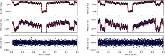

Edit (to address Fraxinus's comment below): Here is an example from Zhang et. al: Phase Curves of WASP-33b and HD 149026b and a New Correlation between Phase Curve Offset and Irradiation Temperature.
The above graphic shows processed data from the Spitzer space telescope. From the paper:
Observations were timed to begin before a secondary eclipse and end after the following secondary eclipse,
These light curves help aid in estimates of planetary albedo, day/night temperature, and atmospheric composition.

    Is the second "dip" really visible for any real star? – fraxinus Feb 11 '21 at 10:45
    @fraxinus Yes, I added an example above. – Connor Garcia Feb 11 '21 at 14:58
    I'm constantly amazed at the precision that we achieve for measurements of distant stars. Intuitively I'd expect this difference to be lost in the noise. – Barmar Feb 11 '21 at 15:43
    @Barmar I definitely cherry-picked an example to show this effect. Wasp-33b is a super-hot Jovian giant with an orbital period of only 1.22 days, so it absorbs and emits tremendous amounts of energy. Most exoplanets' secondary eclipse light signatures would be lost in the stellar noise variations. I don't think aliens from another star system would be able to detect Jupiter's pass behind our Sun! – Connor Garcia Feb 11 '21 at 16:03
