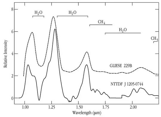

The minimum temperature of an object classed as a "star" is something like 2700 K. Such an object, although emitting the bulk of its radiation in the infrared, would still emit something like a few per cent of its energy at visible wavelengths.
Note that the visible and near infrared spectra of cool stars are nothing like blackbodies, so if the calculation is important then you would need to look carefully at empirical or model spectra.
Lower temperature objects do exist - these are called brown dwarfs. Some have (a subset called Y dwarfs) been found that are only a few hundred kelvins, so a planet could orbit not far above their surface and receive a kW per square metre of infrared light.
A plausible scenario might be a brown dwarf of spectral type T7 (a T-dwarf), with a temperature of about 1000 K (e.g. Burgasser et al. 2002). Such an object has a luminosity of only $\sim 10^{-5} L_\odot$, so a planet would have to orbit at about 0.003 au (about 0.5 million km) to receive the same bolometric flux as does the Earth from the Sun. Such objects cannot be described as "invisible" at visible wavelengths, but a typical $R-J$ (red minus near infrared colour) is about 9 or 10 - indicating that there is thousands of times more flux in the near infrared than there is in the red part of the spectrum. An example of the spectrum of such an object is shown below (GL229b is a T7 brown dwarf). Note how the spectrum is nothing like a blackbody.
A T7 brown dwarf spectrum
