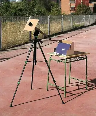

This website shows a telescope projecting the sun onto a blackboard: https://astronomyconnect.com/forums/articles/2-three-ways-to-safely-observe-the-sun.21/
Why isn't the board catching fire? You can easily start a fire on a sunny day by targeting the focal point of a magnifying glass onto something flammable. Why isn't the telescope in this picture doing the same thing?
Telescope projecting sun on a blackboard.

  • ... A blackboard isn't flammable, is it? The surface is generally made out of slate rock, and you're going to need a lot more focused heat than that little telescope can generate to set it on fire. If you put a piece of paper there you might have a problem, but a blackboard should be fine. – Darrel Hoffman Nov 10 '20 at 20:31
    As a matter of fact, that's exactly how my neighbor's house caught fire when he forgot to bring in his telescope (thankfully, they caught it quickly). So it does happen. – Kevin Keane Nov 11 '20 at 00:57
    I had a similar set up with binoculars, unfortunately I forgot to take the lens cap off the eyepiece I wasn't using. It now has a small hole melted into it. – Dave Gremlin Nov 11 '20 at 12:04
    @DarrelHoffman that's not a blackboard - it's white where it's not in shadow. Compare to the bottom right edge of the paper box that's also in full sun Besides a lot of blackboards are black-painted wood – Chris H Nov 11 '20 at 14:23

  • Compare the telescope’s aperture/light-gathering to the size of the image being projected. They are almost the same size, meaning that there is little if any light-concentration occurring. (Unsurprisingly, solar observations require very little light-gathering power) – RBarryYoung Nov 12 '20 at 22:21

It could start a fire if the screen is at the focal point of the optical system. That is how you light fires with a magnifying glass.
Here, the blackboard is likely away from the focal point, so you can see the shape of the eclipse (and you get a bigger image) without setting things on fire.
Although this is fairly safe, there are a few things to pay attention to:
  • If you do this, make sure nobody can walk between the telescope and the screen, because if they go near the focal point, they could get very hot.
  • Doing this will cause your telescope to heat up. If there are any plastic parts, they can melt.
  • The telescope in the picture seems to have a small opening. Don't do this with a big telescope. You don't need to collect a lot of light.

    +1.It should be noted, that the projected image is larger than the telescope aperture. Thus the intensity per unit area on the projection plane is less than direct illumination – planetmaker Nov 10 '20 at 11:50
    Also, am image is never in the focal point as by the image equation 1/f = 1/b + 1/g – planetmaker Nov 10 '20 at 11:53
    @planetmaker That is mathematically true but irrelevant, since when observing the sun with the setup shown the picture, b is about 100,000,000,000 times bigger than f. – alephzero Nov 10 '20 at 17:11

For a magnifying lens or mirror to be able to ignite something with light from the Sun, its surface area must be large relative to the square of the focal length. Solar energy will be spread throughout the projected image, and the size of that image will be essentially proportional to the focal length, making its area proportional to the square of focal length. A typical hand magnifier will have a relatively short focal length, making the projected image quite small. Telescopes, however, are designed to emulate lenses with much longer focal lengths so as to produce larger images. The amount of heating from a telescope will be maximized when it's properly focused, but if the light is spread through a 64mm-diameter image it will be less than 1/1000 as powerful as it would be if it were focused with a shorter lens to produce an image which is only 2mm in diameter.

The key quantity, as others have noted, is the ratio of the objective lens area to the area of the Sun image. Suppose you use a magnifying glass of 70 mm diameter and 180 mm focal length. The Sun's apparent angular diameter is 32 arcmin or 9.3 mrad; the focused Sun image diameter is $$ 180~\text{mm} \times 0.0093 = 1.7~\text{mm} $$ As the lens area is 1750 times as large, the image gets hot quickly, with predictable results.
Now suppose the pictured telescope has a focal length of 500 mm and an aperture of 50 mm (f/10). If you remove the eyepiece and put a card at the prime focus instead, you get a 4.6 mm diameter image illuminated 115 times as strongly as direct sunlight. With a little patience you could still start a fire that way.
If you put the eyepiece back in, you can do eyepiece projection as shown in the picture. Suppose the eyepiece has a nominal focal length of 20 mm and the image is projected 500 mm away. Then you can calculate an effective focal length of 12 m and an effective focal ratio of f/240. The 112 mm diameter Sun image is illuminated only 1/5 as strongly as the direct sunlight entering the 50 mm objective. Not only does the projected image not get hot, but it needs a shade to keep direct sunlight from degrading the contrast. However, the prime-focus image inside the eyepiece is just as concentrated as before, so the time pointed at the Sun should be limited to avoid damaging the eyepiece.

    @supercat The out-of-focus f/10 cross-section 20 mm behind prime focus is 6.6 mm, still 57x as intense as direct sunlight. – Mike G Nov 11 '20 at 01:04

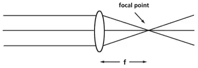

It all depends on how concentrated the energy is. Sun light travels through a lens like this: (left to right)
Lenses and focal points
The closer to the focal point the surface of the board is, the more the light that hits the surface of the lens will be concentrated into a smaller area on the board. More light means more heat, which will start a fire. If the board is further away from the focal point, even though the light hits a larger area, each individual molecule receives less of it, thus no point on the board becomes hot enough to catch on fire.
In the case of telescopes, the lens is at the far end of the telescope, and the focal point is at the end you look through (or fairly close). Thus it's easy to tell how focused the light is going to be based on how many telescope widths away the board is.

    +1 for a simple, accurate explanation with a diagram – Dave Gremlin Nov 11 '20 at 12:07

    -1, because I'm pretty sure this answer is wrong. If the board was not (approximately) at the focal point, the image would be blurred, which it clearly isn't. Instead, as supercat and Mike G correctly note below, what matters is the size of the image relative to the size of the objective lens that collects the light. In this case, the image is projected relatively far from the telescope, and is thus relatively large. If the telescope was refocused to project a smaller image at a closer distance, the light intensity would increase. – Ilmari Karonen Nov 12 '20 at 00:52
