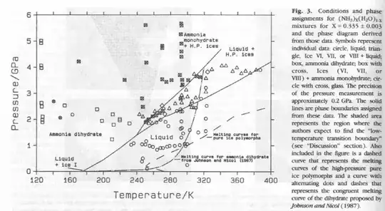

gerrit's answer has done an excellent job of showing that (1) there are a narrow set of temperatures and pressures where liquid water exists and (2) a planet has to be pretty big to have enough gravity to keep water in the atmosphere. However, I wanted to mention this:
However, the conditions required for liquid water can be extended by mixing it with other chemical species.
Salt is often poured onto roads in the winter to melt ice, which is effective because salt water has a lower freezing point and higher boiling point (and is more thermodynamically stable) than pure liquid water. For instance, sea water freezes at 271 K (28 °F), which is lower than the freezing point of pure water, 273 K (32 °F). Coolant in cars usually contains water with ethylene glycol added to depress the freezing point and elevate the boiling point.
This figure from Cynn et al. shows that a mixture of 63% water plus 37% ammonia allows liquid water to exist down to 180 K, although it's hard to tell where the pressure cutoff might be at this temperature from this graph. The pressure cutoff goes down temperature, so it's certainly below 100 kPa. You might be able to sustain liquid water–ammonia mixtures at low temperatures and pressures on the surface of Mars-sized bodies or smaller.
Phase diagram of ammonia–water at a ratio of 37:63
Water–ammonia mixtures are thought to be present beneath the surface of many bodies in the outer solar system, including Titan, Pluto, Charon, and Ganymede. Cryovolcanism based on eruptions of liquid ammonia–water mixtures may be more common than not among the terrestrial satellites beyond Mars.
