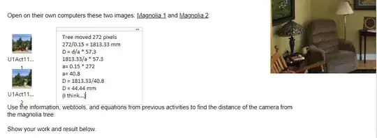

There are three different stages to the lesson. First example with sunset image has a different plate scale than the painting on the wall and the tree, which have the same ~0.15mm/pixel plate scale. She has to do screenshots from a small portion of the browser window. Dumb online learning site is very frustrating. Also it's hard to differentiate between what was originally written and what she has written as she tried to do it before reaching out to me.
The other issue I'm personally having is that there are fundamentally false statements, at least by the standards I have for a science text/course. For instance it says that every camera, no matter how simple or complex, has a fixed plate scale. No, every camera and lens combination does, and only if the lens doesn't zoom. And it seems to me like even changing the focal distance alters the view angle very slightly on at least some of the lenses I've used as a commercial photographer. Another example is the insistence that you are measuring the distance from the camera to the subject. In fact, as the diagram shows, what is being measured is the distance from the subject to the nearest point on the line between the two points where the photos were captured. It's a fine point, but that sort of inaccuracy makes me question everything about the text.
