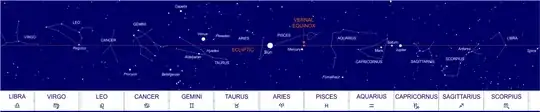

This is not quite an answer but more than a simple comment. When I speak about distances I mean (angular) distances in the sky, when i speak about position I mean position in the sky. I adhere to terrestrial observer's point of view.
1, Starry sky (and everything on it, including Sun, Moon, planets) rotates around a point near Polaris (north celestial pole)
2, A given star (and everything which doesn't move relative to stars) gets to its maximum height above horizon at south (by definition). This is called culmination.
3, Interval between two consecutive culminations of the star is reasonably constant and is called sidereal day. Its length is approximately 23 hours and 56 minutes
4, Sun moves relative to stars along a well defined path, called ecliptic. This image shows starry sky along ecliptic on Apr 12, 2020 with Sun and planets. The ecliptic is the horizontal orange line in the middle.
Zodiac with Sun and planets Apr 12, 2020
5, Sun moves along ecliptic to the left and completes its journey in one year. The length of the ecliptic is 360 degrees, year has slightly more than 360 days so Sun moves by nearly one degree in one day.
