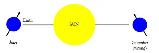

Another factor to consider is that the Earth's rotational axis (the North-South pole axis) has a fixed orientation in space. As the Earth revolves around the Sun, the axis is always pointed "in the same direction" like this:
Some people expect the axis to move like this which is incorrect:
The reason the axis is fixed is due to the inertia of the Earth. It would require an enormous torque to change the direction of the rotation axis like the bottom figure. (Think of a gyroscope - it keeps the spin axis pointed in the same direction.)
Technically, the rotational axis does change. That effect is called precession and is caused by the torque exerted by the Sun and Moon on the equatorial bulge of the Earth. However, it takes approximately 26000 years (not 1 year) to change the direction of the axis through a full arc. Due to precession, the position of alpha Ursae Minoris (Polaris) does change slowly. In a few thousand years, gamma Cephei will be "polaris".
