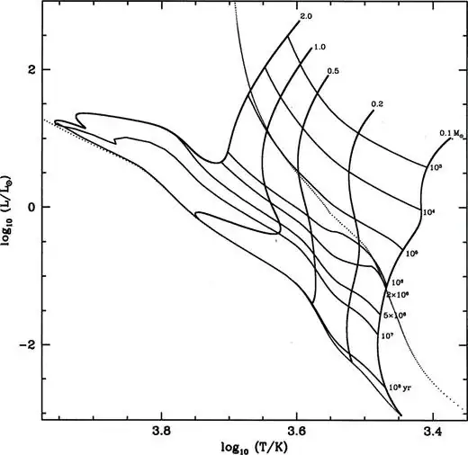

The plot below (from [Tout et al. 1999]) 1) shows the H-burning (lower) and D-burning (upper) "main sequences" for stars as dotted lines in the Hertzsprung- Russell diagram. You can use this plot to estimate the luminosity and radius for a star of a given mass on the D burning sequence. Note the isochrones (line of constant age, running across the diagram, labelled in Myr). There is no convenient formulae that I am aware of.
H and D burning main sequences from Tout et al. 1999
