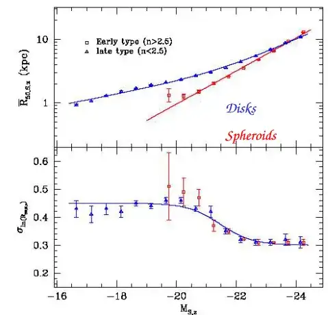

The first Google-hits suggest that Segue 2 is the smallest spiral galaxy, but that is actually incorrect since it is the smallest spherical galaxy yet discovered. It has a radius of roughly 34 parsec or 110 light years. The original publication on that topic dates back to 2013, but it was again in the news in April 2020.
Then, there are lecture notes on a course Astronomy 626 Galaxies which shows the following diagram:
Radius vs. mass for galaxies
Also, the lecture notes claim:
Typical values for the scale length [of spiral glaxies] are: $1 {\rm kpc} < h_R < 10 {\rm kpc}$
I agree that this does not answer your question fully, but I got the impression that the lower bound should be around $1 {\rm kpc}$.

    The (baryonic) T-F relation applies to spiral and irregular galaxies; since the latter tend to be smaller than spirals, the T-F relation cannot reliably be used to estimate lower limits for spiral galaxies. – Peter Erwin Feb 10 '21 at 11:48
