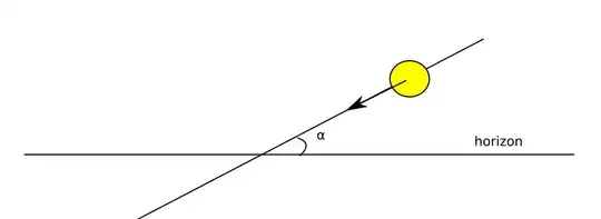

@Calc-You-Later's answer is correct in places where the path of the Sun is perpendicular to the horizon (at the equator during the equinoxes, somewhere between the tropics the rest of the time). There, the sunset lasts 2 minutes. However, at other latitudes, the sunset may last a bit longer.
Let $\alpha$ be the angle the path of the Sun makes with the horizon. This angle depends on your latitude and the date.
The speed of the Sun along its path is $\vec{v_s} = $ 0.25°/min. This speed can be projected along the vertical and horizontal axes. The vertical speed is now $\vec{v_s} . \sin (\alpha)$. The sunset length is still the apparent angle of the Sun divided by the vertical speed of the Sun.
So at higher latitudes, if the Sun sets, for instance, at a 45° angle, then the sunset will last 2 min / sin(45°) = 2.85 minutes = 2 minutes 51 seconds. If the Sun sets with a 60° angle, the sunset will last 4 minutes.
To get the value of $\alpha$, you can add your latitude and the solar declination:
- Determine how many days have passed since December 21st (i.e since the winter solstice). Let's call this number $x$
- Multiply this number by the amount of turning the Earth does in one day $ y = x * 360/365.25$
- Get the cosine of this number and multiply it by the tilt of the Earth $z = -23.5 * cos(y)$. This is the solar declination
- Add the latitude $\theta$ of your location $\alpha = z + \theta $
This does not account for atmospheric effects. The atmosphere will bend the rays of light, and can make it possible to see the Sun even though it is under the horizon.
The atmospheric effects, however, depend on the atmospheric conditions (temperature gradient,...), and are more difficult to quantify.

1Great explanation! However, how cam we know what's the angle in the reality? Is it difference from place to place? – Reckless Glacier Feb 24 '20 at 15:15
2If you happen to be near the Arctic circle on the summer solstice, "sunset" can last for hours. – jamesqf Feb 24 '20 at 18:21
@UbiquitousStudent The angle is different at different latitudes and also different times of the year. – Dronir Feb 25 '20 at 13:12
Thank you. Is there a tool (site) that can predict or give date based on countries and different times? – Reckless Glacier Feb 26 '20 at 03:28
@UbiquitousStudent I don't know if there is a website to compute alpha, but if you know your latitude, you can determine it – usernumber Feb 26 '20 at 07:46
I'm afraid the formula for α here is incorrect. Also $v_s$ is 8% slower at the solstices. – Mike G Feb 26 '20 at 08:24
@usernumber In your terms I figure $\alpha = \cos^{-1} (\sin \theta / \cos z)$. – Mike G Mar 01 '20 at 02:38

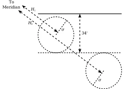

Derivation of (2)
The dotted circles show the Sun's geometric positions when its refracted positions are as in the first figure. Let $h$ be the geometric altitude of the center of the Sun. Meeus §13 gives
$$ \sin h = \sin \varphi \sin \delta + \cos \varphi \cos \delta \cos H $$
Then
$$ \cos H = \frac{\sin h - \sin \varphi \sin \delta}{\cos \varphi \cos \delta} $$
and we can substitute $ h = -34' \pm \sigma $ to get equation (2).
