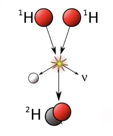

Hydrogen fusion
I'm stealing a bit from other answers, just to clarify the point here. What follows is not exactly how it all happens, but should clarify how electrons and positrons are balanced.
The key to the answer is in this part of the reaction: two hydrogen atoms become one hydrogen atom. A hydrogen atom is made of one electron and one proton and zero or more neutrons. Now in this step, in one hydrogen atom proton flips into neutron, emits a positron, which in turn may annihilate the electron of said hydrogen atom. Thus results in hydrogen atom (with one proton and one neutron and one electron) and two gamma rays.
