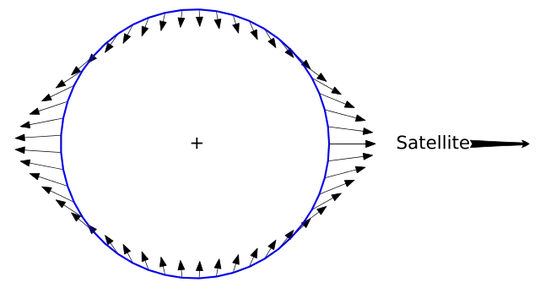

The following diagram from the wikipedia article on the tidal force shows the tidal force that results from a moon.
Depiction of the tidal forcing from a satellite
Note that the tidal force is directed away from the center of the planet when the moon (satellite) is directly overhead or underfoot but is directed toward the center of the planet when the moon is on the horizon. You are right that these very small influences. The tiny changes in the vertical component of the tidal force from the Moon on the Earth have very little effect on the oceans.
What does matter are those places where the angle between the line segment from the center of the planet to the moon and the line segment from the center of the planet to a point on the surface is approximately 45° or 135°. The tidal force is purely horizontal in those places. Minuscule as that tidal forcing is, this horizontal component of the tidal forcing function is unopposed by gravitation the Earth itself. This horizontal forcing makes the waters "want" to flow sideways.
The direction of this flow changes constantly due to the Earth's rotation. The Coriolis effect comes into play precisely because the Earth is rotating. The shapes of the oceanic basins and continental margins also come into play. The end result is a set of amphidromic systems, each of which involves large scale oceanic waves that rotate about amphidromic points.

    "Minuscule as that tidal forcing is": how minuscule is it? How does its magnitude compare to that of the coriolis force? – phoog Aug 16 '19 at 13:42
  • The maximum vertical acceleration occurs when the Moon is directly overhead or underfoot and is about a tenth of a microg (or about 100 nanog). The maximum horizontal is smaller yet, about 3/4 of that. So very small indeed. The Coriolis acceleration is also rather small. The Coriolis effect tends to turn the shallow waves generated by the tidal forces sideways. The horizontal component of the Coriolis effect at the equator is null. (Once again, it's only the horizontal component that matters with regard to a liquid.) It's quite significant near the poles. (continued) – David Hammen Aug 16 '19 at 23:11
    This is why equatorial equatorial amphidromic systems are much larger than are polar ones. This tension between the tidal forcing functions and the Coriolis effects are the primary reason that the so-called tidal bulges do not and cannot exist. – David Hammen Aug 16 '19 at 23:17
