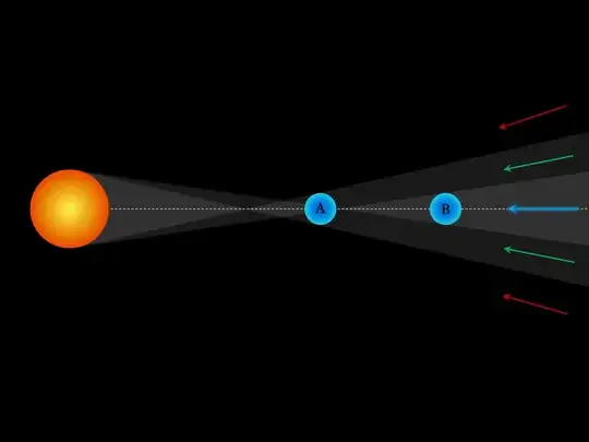

Why did I say almost? Because there is some range of inclinations that still would yield a transit. This range is not fixed, and it depends on the distance of the planet to its host star. As you can see in this diagram:
Enter image description here
Planet A is closer to the star and thus creates a wider shadow. If an observer is located in that shadowed region far away it can detect planet A. Planet B instead is farther from the star and thus its shadow is narrower. It is interesting to note, that even if both planets here share the exact same orbital plane there are places from where you would only detect planet A and never detect planet B (see the green arrows). This is the reason we have a bias towards planets orbiting closer to their star.
