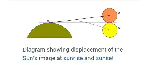

When the sun is about to rise for a given location is disk or photosphere is totally covered by the planet. The situation is similar to that of a total eclipse but we can't see the corona rising first because of two and at least overlapping reasons :
  • the corona image undergo multiple diffusion and reflection and is not bright enough to contrast with the skydome which is already illuminated by the same;
  • when the sun further approach a "geometrical sunrise" refraction makes it already visible so its light is overwhelming the corona anyway
Picture from Wikipedia
https://en.m.wikipedia.org/wiki/Atmospheric_refraction
The corona is somehow hidden in the twilight.
