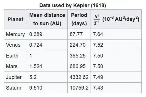

Kepler’s original values for the ratios were: enter image description here
Kepler thought that “a more accurate number will be produced, if you take the times more accurately.” Kepler attributed all the inaccuracies in his data set to measurement error. However, Newton proved Kepler wasn’t quite correct.

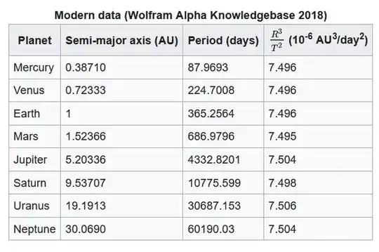

Newton generalized Kepler’s third law as $$\frac{a^3}{p^2}=\frac{G(m_1+m_2)}{4\pi^2}$$, where G is the gravitational constant, $m_1$ is the mass of the sun, and $m_2$ is the mass of the planet, respectively. This generalization implies that $a^3/p^2$ will be different for each of the planets, since they all have different masses. The largest differences manifest for the planets with the highest masses, but even for Jupiter, these differences are along the third significant digit, consistent with our current best estimates here: enter image description here
These values correspond well to my calculated predictions bases on Newton's generalization of Kepler's third law:
