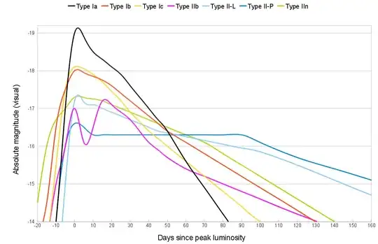

No, it would not be a problem. Supernovae are not at all like flashbulbs – they brighten over a period of many days and dim again even more slowly. Here are a number of different light curves taken from Wikipedia: Luminous output of different types of Supernovae
The rise is fast on an astronomical scale – several orders of magnitude over a period of roughly ten days – but very slow on a human scale. An amateur looking at it would not notice any significant change in brightness, but if the same person came back a few hours later or the next night, the change would be very evident.
As far as we can tell, the reason is that the light at peak brightness is caused by emissions from material blown off by the explosion. For example, in Type 1a SNe, most of the light is from the radioactive decay of the huge mass of ejected nickel-56 (half life 6 days).
The Wikipedia article on supernovae is quite good and covers this all in more detail.

    This answer explains that the brightness increases gradually, but doesn't seem to answer the question as to whether or not a person watching Betelgeuse would go blind (unless we count "no, it would not be a problem" as the answer). – JBentley Dec 10 '18 at 13:10
    Note that the OP asked if there'd be an "unpleasant surprise" -- the answer is, "No, there would be no surprise." You would not be blinded unless you really wanted to be. Obviously if you stare into a bright enough light with a big enough telescope for a long enough time you can blind yourself in one eye -- you'd have to do it all over again with the other, of course. I don't feel that constitutes a "surprise." – Mark Olson Dec 10 '18 at 13:44
  • @JBentley It's not fast enough and it's not bright enough to blind you. – Florin Andrei Dec 10 '18 at 19:03
    @Mark Olson : Yep. OP is almost surely imagining it being like a camera flashbulb (or perhaps, a nuke?) "suddenly" going off and you are looking into said flashbulb with your telescope. But it's not. – The_Sympathizer Dec 27 '18 at 10:46
