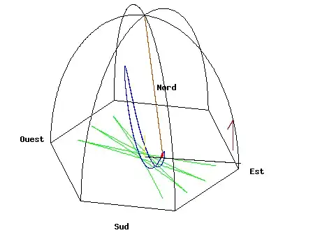

A pendulum
One object is a Foucault pendulum.
Foucault pendulum Source

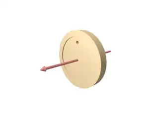

A gyroscope
Another is an (expensive) camera with inertial image stabilization. Some cameras have small gyroscope chips that sense very tiny rotations of the camera body and compensate with image processing.
enter image description here Source
