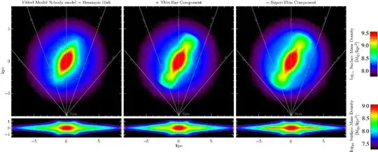

It's much harder to figure this out for the Milky Way, because we're not looking down it from above. The best attempt to derive a model of the bar's 3D stellar density from star counts and distance estimates that I know of is Wegg et al. (2015). From the face-on projected view of their model (their Figure 14), I would guesstimate the maximum contrast as a factor of 4 or so.
Face-on view of Milky Way from Wegg et al. (2015)
Figure 14 of Wegg et al.: projected face-on view of stellar density for the Milky Way (full model in right-hand panel).
The 3D density (which is maybe what you're really asking about) in the inner part of the bar is not quite as great as this suggests, because the inner part of the bar is vertically thick, forming a "boxy/peanut-shaped" bulge (this would correspond to the red region in the figure above). So the contrast would be a little less compared to the (less thickened) inter-bar region. But the outer part of the bar is roughly as thin as the rest of the disk, so the projected surface density contrast would mean a similar contrast in 3D stellar density.

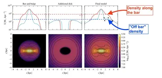

In the Milky Way, the density in the bar seems to roughly 5 times larger than "next to the bar".
The most recent model of the Galactic bar I could find is Portail et al. (2017), whose model is constructed to match a range of observational surveys (VVV, UKIDSS, 2MASS, BRAVA, OGLE, and ARGOS). The figure below from this paper shows the density profile of the bar/bulge (left panel), the disk (middle panel), and the combined mass (right panel).
The red curve shows the density along the bar (i.e. the major axis), and the blue curve shows it perpendicular hereto (the minor axis). The central bump in the blue curve thus is inside the bar, but after roughly 2 kpc (i.e. 6-7000 lightyears), it flattens out. Here the mass (surface) density is roughly $10^9\,M_\odot\,\mathrm{kpc}^{-2}$. Off-bar, however, the blue line shows that the density is only $2\times10^8\,M_\odot\,\mathrm{kpc}^{-2}$, i.e. 5 times lower.
