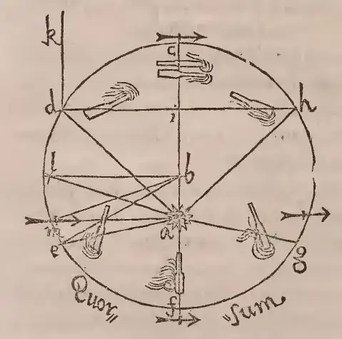

It isn’t immediately clear from Kepler’s own statement of his first law if the sun or the barycenter is the occupied focus. Indeed, I couldn’t even find a mention of a focus in Astronomia Nova. The closest I could find is when Kepler says, “a planet is moved less vigorously when it recedes from the point whence the eccentricity is computed.” Here, it appears that Kepler is referring to the fastest speed of a planet at Perihelion, and the slowest speed at Aphelion. The point from "whence the eccentricity is computed" is also clearly the focus of the ellipse. Here is one of Kepler's original woodcuts, and it can be seen that the sun is at the focus. Kepler used the metaphor of a row boat for the planet's motion, and his drawings of oars in the water complement this cutting. Kepler's solar system conception

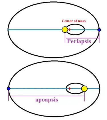

  4. Implications: The fact that Kepler’s laws didn’t include a barycenter is not just a historical curiosity, but also informs our modern conventions. A Kepler orbit assumes that a less massive body orbits around a more massive one in an ellipse, with the more massive body at one of the foci of that ellipse. Though Kepler’s laws can be generalized to replace the sun with the barycenter, they are no longer recognizable as Kepler’s laws and will no longer conform to convention. All the orbital elements would be different. For example, the periapsis and apoapsis are always measured from the central body, rather than the barycenter. Here is a diagram from wikipedia:
