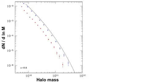

The figure below (from Klypin et al. 2011) shows halos from the Bolshoi simulation identified with the two methods; SO (red points) and FoF (blue points), compared to an extension of the P-S HMF (solid black line) to allow for ellipsoidal structures (Sheth & Tormen (1999, 2002). At all masses, FoF halos are seen to be more massive than SO halos.
HMF
