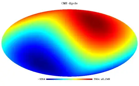

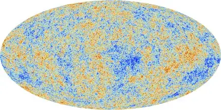

Well... it is not entirely true that there is no absolute velocity reference: the WMAP probe, measuring the minor perturbations of the cosmic microwave background radiation, found also a relativistic Doppler effect, from which you can read more here. In essence, this is what it measured:
Plank CMB
However, the results actually measured were these:
Dipole Map
The deviation is due to our galaxy's movement of around 160km/s in the direction of the constellation Hercules, in an reference frame of the Cosmic Microwave Background, that is the closest thing there is to an absolute reference frame.
The answer of your question in this frame: all other movements (of the Sun, the orbit of the Earth around the Sun, and the orbit of the Moon around the Earth) are negligible or cancel themselves out. The result can be gotten by multiplying:
  • the speed in the frame of the CMB (160km/s)
  • the seconds of a year ($\approx$ 31.5million)
It is $\approx 160\frac{km}{s} * 31.5\cdot 10^7 s = \underline{\underline{5\cdot 10^{10} km}}$.
