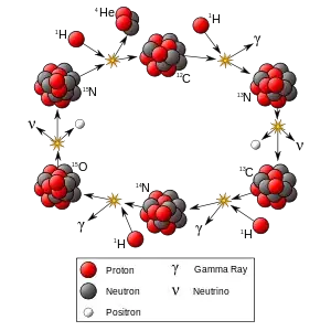

Remember what's happening: Temperatures are hot enough for hydrogen in the core to be completely ionized, meaning that in order to fuse these protons into helium nuclei, you need to overcome the electromagnetic repulsion as two protons come close (like charges repel). Below is a diagram of the process of one particular type of fusion (Proton-proton chain reaction).
proton-proton

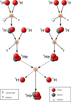

The other fusion reaction which occurs at the cores of stars is called the carbon-nitrogen-oxygen (CNO) cycle, and is the dominant source of energy for stars more massive than about 1.3 solar masses. Below shows this process.
CNO
