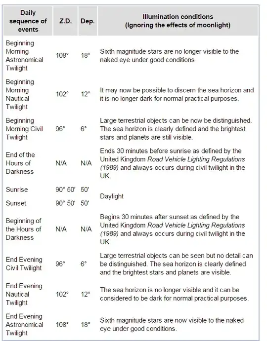

For an explanation see Wikipedia's Sunrise Equation webpage.
This is the algorithm for rising/setting times:
Sunrise/Sunset Algorithm
Source:
Almanac for Computers, 1990
published by Nautical Almanac Office
United States Naval Observatory
Washington, DC 20392
Inputs:
day, month, year: date of sunrise/sunset
latitude, longitude: location for sunrise/sunset
zenith: Sun's zenith for sunrise/sunset
offical = 90 degrees 50'
civil = 96 degrees
nautical = 102 degrees
astronomical = 108 degrees
NOTE: longitude is positive for East and negative for West
NOTE: the algorithm assumes the use of a calculator with the
trig functions in "degree" (rather than "radian") mode. Most
programming languages assume radian arguments, requiring back
and forth convertions. The factor is 180/pi. So, for instance,
the equation RA = atan(0.91764 * tan(L)) would be coded as RA
= (180/pi)*atan(0.91764 * tan((pi/180)*L)) to give a degree
answer with a degree input for L.
