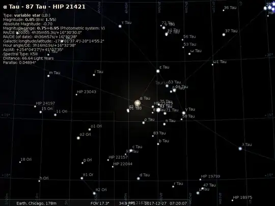

This should really be a comment, but... you can usually check your calculations using a program like Stellarium (screenshot above).
From the latitude/longitude and right ascension/declination you give, it appears you are viewing Aldebaran from Chicago, IL at 7:20am UTC on 2017-12-27 (since Chicago is on Central Time and not observing Daylight Saving Time, which is 6h behind UTC).
As you can see from the above, the hour angle is about 3h16m19s (or 49.16 degrees), the azimuth (which is what I think you actually wanted instead of hour angle) is about 254 degrees, and the altitude is about 41 degrees.
