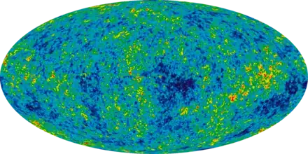

  • No matter what exactly happened at the big bang, we know the state of the universe at roughly the age of ~380.000 years, where the universe becomes transparent (more or less instantaneous, but let's omit that discussion). At this moment, matter emits light that teaches us the distribution of matter in the young universe. This is the Cosmic Microwave Background Radiation.
  • In the CMB we see that matter is remarkably homogeneous, apart from very small fluctuations, that help us build the cosmological standard model. This means at the time of the CMB emission, the universe had nearly the same matter density everywhere. Which is the contrary of clustered matter blobs (galaxies) that we see today.
CMB fluctuations
Fig. 1: CMB temperature fluctuations as seen by WMAP.
Those variations can be translated into density fluctuations, given a physical model. To our current understanding the form the seeds of galaxy growth.
