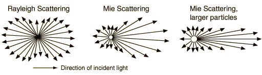

You basically would need impressive amount of gas to account for the extinction just by Rayleigh scattering. Instead, Mie scattering is more important in this context. Here a figure to quickly grab the concept (from here):

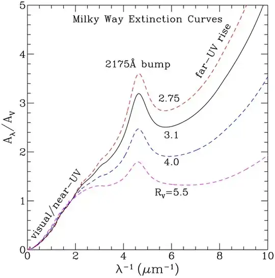

And here a very popular plot about extinction versus frequency from here:
