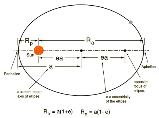

If the Moon formed close to the Earth, which most models suggest it did and since it couldn't pass inside 3 Earth Radii and stay solid, those numbers put a limit on how eccentric the initial orbit probably was. If we use the 5/3 Earth Radii as an estimate, Ra=5, Rp=3, then the eccentricity is 0.25, and that's an estimate for the upper limit of the initial eccentricity after formation. It may well have been quite a bit less.
http://hyperphysics.phy-astr.gsu.edu/hbase/imgmec/kep.gif
But for the sake of argument, lets give the newly formed moon an eccentricity of .25 or, maybe a little higher with a more distant apogee, but we have to keep the perigee at 3 Earth radii or greater. Your question still stands, how did the Moon's initial eccentricity become somewhat circular.
