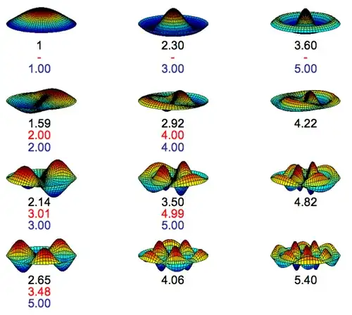

While oversimplified, the sun behaves like a drum in regards to it's internal soundwaves. The sun is also very very loud, inside and on the surface.
If you played a drum in a vacuum, you couldn't hear it, but you could observe the motion of the drum's surface and work out what it would sound like by visual observation only. Same with guitar strings. The vibration is visible in wavelength and amplitude.
Exaggerated, the pattern on a drum would look something like this.
Source of picture.
That's basically how the Sun's soundwaves are studied. It's often compared to Sonar but I don't like that comparison because sonar works by sending a soundwave out and seeing what gets reflected back. It's more like the visual observation of sound vibrations, or, like studying a drum by looking at it's vibrations instead of listening to it.
