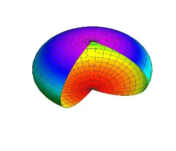

Current understanding is that star is an oblate spheroid. An extreme example is shown below.

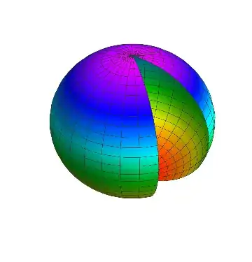

For a neutron star, the difference between the polar diameter and the equatorial diameter is around 10% and would look more like this:

@Rob Jeffries: I will chase the reference down and send it. Would love another opinion. – dantopa Apr 24 '17 at 19:05
Logically speaking, they should be spherical as things with higher gravity tend to collapse into spheres. Neutron stars are extremely dense, and have high gravity. However, they are as far as we know rotating extremely fast as well (e.g. Pulsars). It should be that the faster they rotate, the more disc-like they would become (like an ellipse or slight possibility of more of a disc in extreme cases). So, depending on rotation speed, sphere for no to fairly high rotation speed, ellipse for high rotation speed, or possibly even a disc for extremely high rotation speed. There is room for debate here, but this is how I logically see it.
Edit: By ellipse, I mean a 3 dimensional ellipse, like an egg, but "squished the other way". Basically a sphere that has been stretched out on its equator. The faster it spins, the more it should be deformed (stretched along the equator). Dantopia's answer shows the shape I am describing.
