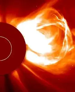

When looked at via a single still image, it does indeed appear that material is looping up only to fall back to the Sun.
A still image of a coronal mass ejection, apparently showing lines of material that appear to move away from the Sun only to later fall back onto the Sun.

A better view of a coronal mass ejection became available once those satellites had the ability to send more than an image per hour back to Earth. The image below portrays a coronal mass ejection that occurred in 2001.
A time lapsed image of a coronal mass ejection, clearly showing large volumes of material being ejected from the Sun
