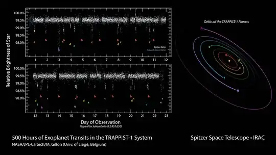

The planets of the TRAPPIST-1 were discovered by the method of transit photometry. The way this works is a telescope watches a star for a period of time and records the amount of light coming from the star. They chart how much light is coming from the star as a function of time, creating a light curve. If they see periodic dips in the intensity from the star, there is a high likelihood that that star has a planet in orbit around it. The planet blocks the light from the star every time it passes between us and the star. This causes the dips in the light curve. One advantage to this method is that you can scan multiple stars in the same field of view, analyzing them all for planets.
By measuring how long it takes planets to pass in front of the star, how much light it blocks, and how often they orbit, scientists can calculate the masses of these planets and how far away from the star they are by using Kepler's laws of motion.
TRAPPIST-1 was initially determined to have planets orbiting it by the Transiting Planets and Planetesimals Small Telescope - South team. From their data they determined that it had at least 3 planets. One of these planets was in the habitable zone of the star. They published their results in the journal Nature in May 2016.
Once TRAPPIST had determined that the system had planets around it, NASA trained the Spitzer Space Telescope on it. Ground-based observations of Trappist-1 are difficult because it is so dim. Spitzer, an infrared telescope, made more precise measurements of the light curves and determined that there were at least 7 planets in orbit around it, 3 of which were in the habitable zone. Additional observations were made by numerous other telescopes including the Very Large Telescope, UKIRT, the Liverpool Telescope, and the William Herschel Telescope. The results were also published in Nature.
TRAPPIST-1's light curve Here's an image showing the light curve of the TRAPPIST-1 system as measured by Spitzer.

  • Do you happen to know how long between the dips of light are(and how long they last for)? Thanks – Cruncher Feb 24 '17 at 22:42
    @Cruncher the length and period of the dips depend on the period of the planets and size of the star. Since Trappist-1 is so small and the planets are all orbiting very close to it, the dips for the innermost planet occur about every 1.5 days, while the outermost planet probably circles every 20 days. In each case, the dip only lasts for a few hours. I'll add a picture showing the light curve to the answer. – Phiteros Feb 24 '17 at 23:28
