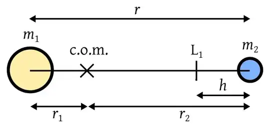

Now consider a two-body system with masses $m_1$ and $m_2$, separated by a distance $r$ orbiting their common centre-of-mass (c.o.m.) at distances $r_1$ and $r_2$ respectively.
Diagram showing the setup for L<sub>1</sub>
This is a one-dimensional system, so we can switch from vectors to scalars. From the definition of the centre-of-mass, we have:
$$r_1 = \left(\frac{m_2}{m_1 + m_2}\right) r$$ $$r_2 = \left(\frac{m_1}{m_1 + m_2}\right) r$$

Next we find the distance to the L1 point, where the gravitational forces of the primary and secondary combine to provide the required acceleration for circular motion. Equating the acceleration for circular motion with the gravitational forces gives:
$$\omega^2 \left(r_2 - h\right) = \frac{G m_1}{\left(r - h\right)^2} - \frac{G m_2}{h^2}$$
And substituting $\omega$ results in:
$$\frac{\left(m_1 + m_2\right)\left(r_2 - h\right)}{r^3} = \frac{m_1}{\left(r - h\right)^2} - \frac{m_2}{h^2}$$
Then rewrite this in terms of the mass ratio $q = \frac{m_2}{m_1}$ and the relative distance $z = \frac{h}{r}$, giving:
$$1 - z\left(1 + q\right) = \left(1 - z\right)^{-2} - qz^{-2}$$
This results in a quintic equation for $z$, which must be solved numerically as general quintics do not have algebraic solutions (I'm not going to pretend to understand the proof of this).
