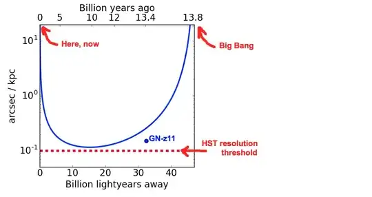

Angular diameter in an expanding Universe
The reason is a rather peculiar feature of the expanding Universe: A galaxy will look smaller and smaller, the farther away it is (as expected from everyday life), but only out to a certain distance, after which they will appear larger and larger. Why is this so? Because light moves with a finite speed, we observe galaxies as they were in the past — the more distant, the longer time ago. And since in an expanding Universe, "long time ago" also means closer, the angle that a galaxy spans on the sky is the angle that it spanned when it emitted the light, not the angle it spans today. That is, very distant galaxies emitted the light we see today when they were so close that they spanned a large angle.
The exact relation between distance and the solid angle of a galaxy depends on the cosmology (i.e. the values of density parameters, Hubble constant, etc.). For the latest Planck measurements (2015), a galaxy that is 1 kpc (~3000 lightyears) across — which would be considered a small galaxy — spans an angle given by this figure:
arcsec_kpc
You'll see that galaxies look smaller and smaller the farther there are away, until at a distance of roughly 15 billion lightyears, after which they look larger again. The most distant galaxy observed, GN-z11, is so far away that its light was emitted less than half a billion years after the Big Bang. With a radius of $0.6\pm0.3\,\mathrm{kpc}$ (Oesch et al. 2016) it still spans 0.15 arcsec, which is resolvable by HST.
Decreasing surface brightness
Unfortunately, this effect also makes distant galaxies more difficult to detect. A galaxy only emits so much light, so distributing its light over, say, twice the angular diameter, makes it four times less bright.
Thus, the problem of observing very distant galaxies is not that they're small, but that they're dim.

  • @pela Will it make sense to think of this as follows: when new galaxies become visible in our Cosmological Horizon, they would span across a larger angular diameter and thus appear bigger, even if very faint? – Dhruv Saxena Apr 13 '17 at 00:39
    @DhruvSaxena: In principle yes, but if you could see all the way to the horizon, you would look back in time all the way to the Big Bang ($z\rightarrow\infty$) where no galaxies had yet formed. We cannot really see any farther than the CMB ($z\simeq1100$), but even then there were no galaxies. We already are able to see some of the very first galaxies, which formed a few 100 million years after BB ($z\sim10$). In principle they should look large and faint, but the effect is somewhat counteracted by the fact that galaxies at that time simply had not grown to be so large as they are today. – pela Apr 13 '17 at 08:06
