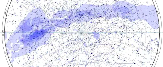

I'm looking for some sort of boundary data to be able to render the milky way on a star map, as visible from Earth. Something that looks like this:
star map
For that, I need something like a collection of RA hours and DEC degrees of the "boundary points" of what's visible from Earth (technically the Galactic Center), possibly with proper motion too. I'm not looking for precise luminosity data or anything like that, just the points of the blob on the sky that most resembles the Milky Way's shape and position from the Earth. It's important that I want to render the sky map for any given surface point on Earth, for any given time (within the last 100 years at least).
Do you know of a database like that? I've been looking on VizieR but I couldn't find what I was looking for.

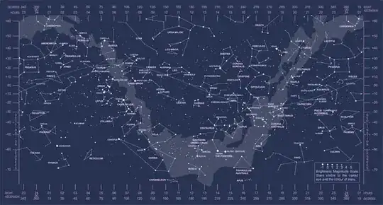

Following @Petoetje59's idea of using the data in the "mw.json" file I was able to add a fine Milky Way contour rendition to my proper motions planisphere project.
I just took all the coordinate pairs en masse, eliminated all the brackets and code, added line feeds at the end of each pair and pasted them on a spreadsheet, where I could make the stereographic projection of all the points.
Finally I plotted the projected points in Inkscape, separated each individual contour polygon and stacked all of them; by coloring them in transparent blue I got that nice layered look.
Thanks very much!
Milky Way Contour
