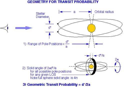

Transits can only be detected if the planetary orbit is near the line-of-sight (LOS) between the observer and the star. This requires that the planet's orbital pole be within an angle of $d_*/a$ (part 1 of the figure below) measured from the center of the star and perpendicular to the LOS, where $d_{*}$ is the stellar diameter (= 0.0093 AU for the Sun) and $a$ is the planet's orbital radius.
This is possible for all $2\pi$ angles about the LOS, i.e., for a total of $4\pi d_*/2a$ steradians of pole positions on the celestial sphere (part 2 of figure).
Thus the geometric probability for seeing a transit for any random planetary orbit is simply $d_*/2a$ (part 3 of figure) (Borucki and Summers, 1984, Koch and Borucki, 1996).
Diagram
For the Earth and Venus this is 0.47% and 0.65% respectively (see above Table). Because grazing transits are not easily detected, those with a duration less than half of a central transit are ignored. Since a chord equal to half the diameter is at a distance of 0.866 of the radius from the center of a circle, the usable transits account for 86.6% of the total. If other planetary systems are similar to our solar system in that they also contain two Earth-size planets in inner orbits, and since the orbits are not co-planar to within $2d_*/D$, the probabilities can be added. Thus, approximately $0.011 \times 0.866$ $= 1\%$ of the solar-like stars with planets should show Earth-size transits.
