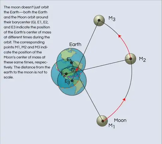

Finally, and just for fun, it makes logical sense to me that the Moon orbiting the Earth creates small apparent fluctuations at least from the point of view of the Earth, because the Earth in effect orbits the Earth-Moon barycenter in an ellipse roughly 1/81st the size of the distance to the moon, or about 4,480 KM in radius every 29 days. Depending on whether the Moon is ahead of the earth or behind it, the Earth year can change by as much as 5 minutes. I suspect that this is largely ignored when measuring Earth years though and the Earth-Moon barycenter is used. If we measured the Earth's center we should get much larger variations year to year. (see picture).
Source.
