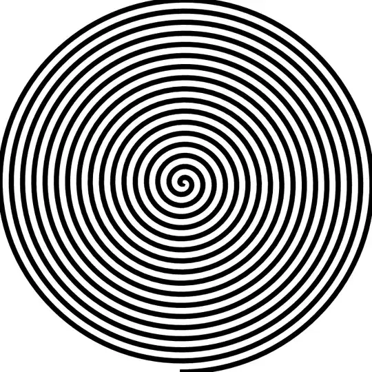

If you could see a pulsar beam, it takes light 8 minutes to for light to travel 1 AU, and a pulsar can rotate hundreds of times, perhaps thousands of times in 8 minutes, so if you could actually see the beam, it would be enormously curved, like a spiral. The light itself would travel in a straight line but since the source of the light was rapidly rotating it would appear like this (picture below), if there was sufficient material for the light to reflect off of (which there probably wouldn't be, not within 1 AU).
http://orig10.deviantart.net/193f/f/2011/095/d/9/spiral_by_10binary-d3dbvut.png
In reality, it would look nothing like that, but if you could see the the beam, that's what it would look like. What that spiral looks like from a single point is a pulsar, off, on, off, on, off, on, etc.
Also, the light never travels in a spiral, it travels in a direct line away from the Pulsar, but like the water spiral here, which falls down in a straight line, but it looks like it falls in a spiral (if that makes sense).
