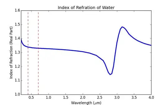

The colors that we see in rainbows has to do with a few things. First, its the variability of the index of refraction of water as a function of wavelength. Since the index of refraction is different at different wavelengths, as light propagates through the water, the different colors split up. This happens over a wide range of wavelengths outside of the visible range as seen below (data from here, I edited the plot because excel did something strange stretching out the x-scale)
You can see that in the visible range ($\sim 0.4\mu\text{m}-0.7\mu\text{m}$, dashed red lines), the slope of the index is not very large compared to other parts of the spectrum, so for stars of different colors, you might see a larger spread in the colors in the rainbow, allowing you do distinguish between more or less wavelengths of light depending on what part of the spectrum you are in (if you could perceive this light, I'll discuss this later).
Second, the rainbow that we see is dependent on the sensitivity of our eyes at certain wavelengths. There are more colors in the rainbow than we can perceive beyond red and violent (hence the names infrared and ultraviolet). In within the visible spectrum, the rods and cones in our eyes can only distinguish between so many wavelengths. Also, the concept of "different" colors outside of our visible range doesn't have much meaning either, since we don't know how they would be distinguished.
Finally, for different stars, the colors that you would see would really depend on what light is coming from the stars and where they fall on this curve. Our visible range is fixed, so if we confine ourselves to that, the colors won't change much, but the relative brightness between them will. And as the stars light changes color range, some colors will appear brighter than the would from the sun. Others may be to faint to perceive. If we had a wider range of sensitivity, it would be more colorful than we could possibly imagine in some cases.

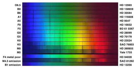

Just for completeness, here's another angle:
Yes, as Joseph von Fraunhofer and many other people have demonstrated.
There's a whole scientific discipline that, putting things somewhat simplistically, involves making rainbows out of the starlight from non-Sol stars and seeing what they look like. It is optical stellar spectroscopy. So yes, there already are such rainbows, and people do know how they differ from the ones made by light from Sol.
Get into that in detail, of course, and one learns that "Sol is a yellow star" and "There are seven colours." are (gross) simplifications. You've already seen from other answers here that there is a wealth of complexities, including the effect of the local star upon weather and the existence of liquid water rain, questions about what atmosphere one has and what time of day it is, and how much atmosphere (and indeed what purity of water) one is looking through. The study of rainbows is actually quite complex.
Given that, it's quite difficult to answer such questions, because Sol is not really yellow, that largely being an artefact of looking at a star that emits all colours through a certain atmosphere in a certain way; and there are only "seven colours" if (a) one adopts certain cultural and linguistic biases and (b) one ignores the rest of the electromagnetic spectrum, which astronomers most definitely do not (radio and x-ray stellar spectroscopy also being scientific disciplines).
Sticking to visible light for the sake of simplicity, therefore: Here is a set of "rainbows" made from other stars by the Kitt Peak National Observatory 0.9m Telescope on the 30th of May, 2000:
The codes down the right hand side are astronomical stellar catalogue numbers of the individual stars whose light was used to make each one. This should give you the beginnings of an idea of what rainbows made by different stars would look like. But it's quite a complex thing. Just look at what a solar rainbow really looks like. Here's what a solar rainbow looks like when viewed in great detail (by the McMath-Pierce Solar Observatory on the 30th of August, 2000):
It's not yellow, and there are a lot more than seven colours. ☺
