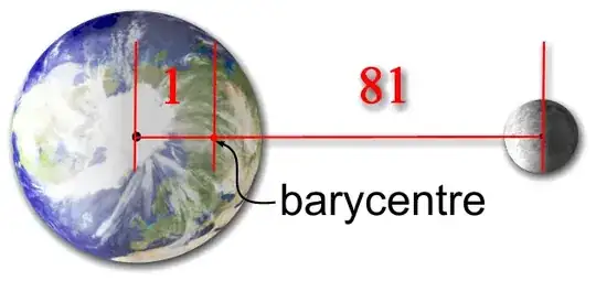

The ratio of Earth and Moon's masses is $\frac{M_{Earth}}{M_{Moon}} = 81.3$ whereas for Pluto and Charon the same ratio is $\frac{M_{Pluto}}{M_{Charon}} = 8.09$.
Because the ratio for Pluto and Charon is relatively small, the center of the system – barycenter, around which the two bodies orbit – is somewhere on a line drawn between the two celestial bodies's mass centers. But for Earth and Moon, because Earth is proportionally much heavier, the system's barycenter does not reach outside of Earth, but instead is about 4,500 kilometers from the center of Earth (see the photo below, too):
In cases where one of the two objects is considerably more massive than the other (and relatively close), the barycenter will typically be located within the more massive object. Rather than appearing to orbit a common center of mass with the smaller body, the larger will simply be seen to "wobble" slightly. This is the case for the Earth–Moon system, where the barycenter is located on average 4,671 km from the Earth's center, well within the planet's radius of 6,378 km. Source: Wikipedia - Barycenter
