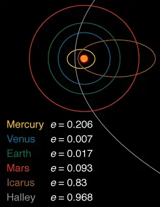

It is posible for a planet to have a circular orbit, a circle, after all, is an ellipse where both foci are in the same place; this is known as having an eccentricity of 0. Eccentricity is defined in the following way: $$ e = \frac{r_{a} - r_{p}}{r_{a} + r_{p}} $$ where $r_{a}$ is the apoapsis (farthest point in the orbit from the center of mass), and $r_{p}$ is the periapsis (the closest distance). Just to build some intuition here, if the apoapsis is twice the distance of the periapsis, the eccentricity will be $e=0.333$.
From all the planets of the solar system, Venus, with an eccentricity of 0.007 has the most circular orbit.

Here's an image showing eccentricity of some bodies in the solar system extracted from here:
Some solar system bodies and their excentricities
