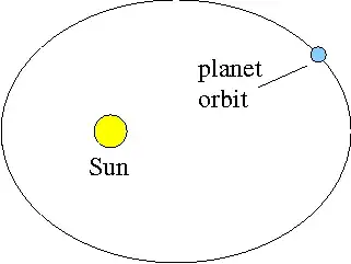

The closest point of the Earth's orbit (perihelion) and the farthest (aphelion) only happens once per year; not twice. That is because the elliptical orbit of the Earth is such so the sun is at one of the foci, not the center (as illustrated below).
Earth's Elliptical Orbit](http://i.imgur.com/hxAbz8y.png)
Note that the size of the bodies and the eccentricity of the orbits are greatly exagerated here.
