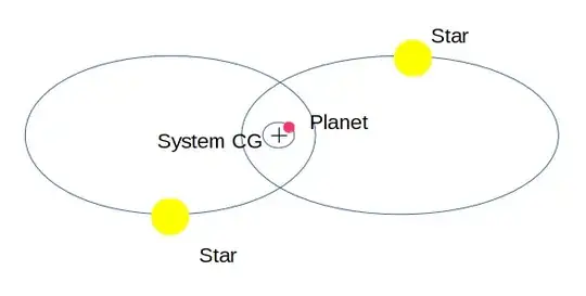

I know of three sets of stable orbits in a binary star system: orbiting closely around star A, orbiting closely around star B, or orbiting distantly around both stars (and their mutual center of gravity) at once.
Is there a fourth set of stable orbits, around the mutual center of gravity, but inside both stars' orbits?
Two stars orbiting their mutual center of gravity, with a planet orbiting that same point
Mark
  • 3,373
  • Can you draw a picture of what this would look like? – HDE 226868 Jul 26 '15 at 13:25
    I've added an image. – Mark Jul 26 '15 at 19:45
  • I strongly suspect that's not stable long term, even though the planet does orbit the 2 stars center of gravity. I find it hard to believe that wouldn't rather quickly destabilize. There's a handful of calculated 3 body scenarios that work, my favorite is the figure 8 (this one is 3 equal bodies) http://www.ams.org/featurecolumn/images/simo03.gif and more here: http://news.sciencemag.org/physics/2013/03/physicists-discover-whopping-13-new-solutions-three-body-problem. Your question is slightly different, but I still feel pretty confident in saying that wouldn't be stable for long. – userLTK Jul 27 '15 at 08:15
    You can't have an orbit like that. There is no force toward the barycenter. This planet would be shot out of the binary system at high speed in no time flat. – David Hammen Jul 28 '15 at 18:26
