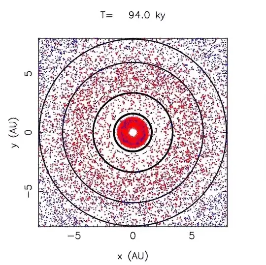

But in the 5th second (~94,000 years model time)...

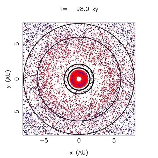

Saturn makes its move Saturn still moving fast
We see Saturn make a very rapid move inwards. This is the main reason I suggest playing it slowly, as you can very easily miss it and lose track of where each solid black orbit has come from. By model time 98,000 years (still in the 5th second of the video time), Saturn has already come to within about 2 AU of the Sun; Jupiter is still about 1.5 AU, and there is a thick concentration of mostly rocky planetesimals within 1 AU. Saturn and Jupiter rebound back out
By model time of about 120,000 years, Saturn and Jupiter are rebounding back out into the outer solar system, to much the same distances we see today, scattering most of the planetesimals that remained in the areas that would become Mars and the asteroid belt. This leaves a fairly dense disc of material for Earth, Venus, and Mercury to form and grow from, while leaving significantly less for Mars, and lesser still for the asteroid belt.
