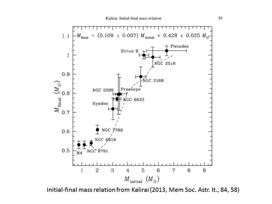

A recent compilation from Kalirai (2013) is shown below. This shows that a star like the Sun, born with an initial mass of $1M_{\odot}$ (or maybe a per cent or two more, since the Sun has already lost some mass), ends its life as a white dwarf with $M = 0.53 \pm 0.03\ M_{\odot}$. i.e. The Sun should lose approximately 50% of its initial mass in stellar winds and (possibly) planetary nebula ejection.
IFMR from Kalirai (2013)
